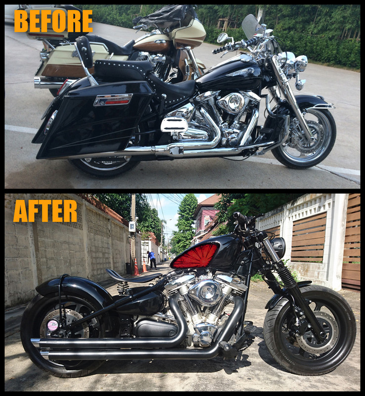

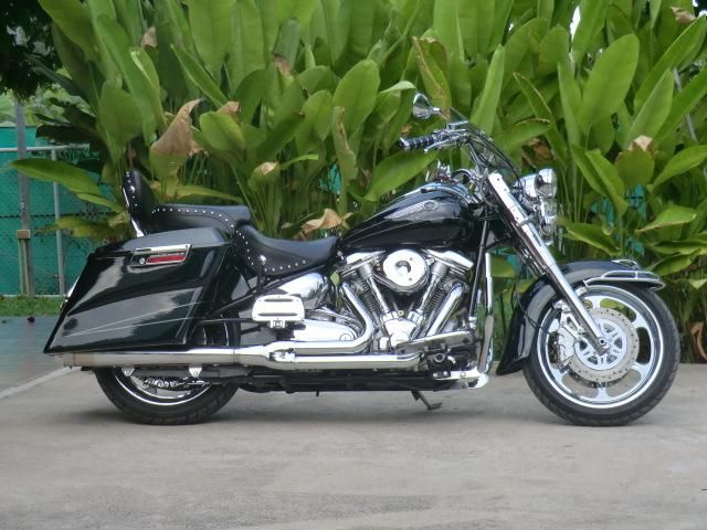

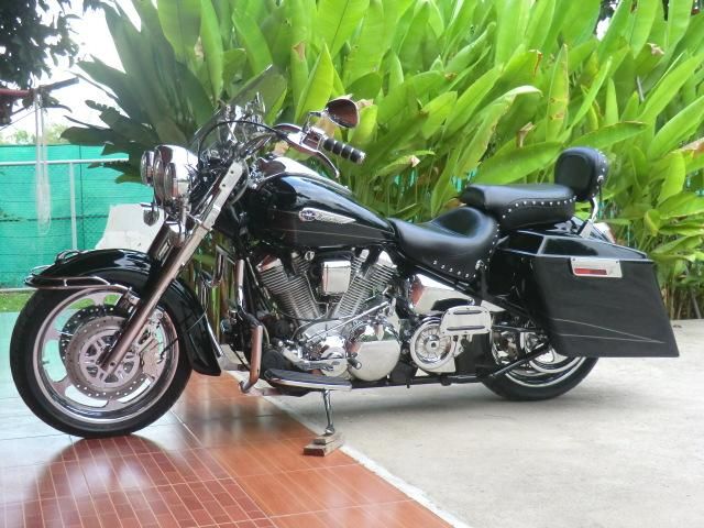

    When I bought my 2001 RS a couple of years ago, it had already been very substantially customized / upgraded / rebuilt by its previous owner, who, besides becoming a friend, did a fantastic job at turning it into a sexy bagger:
    Non-exhaustive list of the mods / rebuild at time of purchase:
    - New swingarm bearings and spacers
    - New progressive suspension (rear shock)
    - New neck bearings
    - 18in RC Components Wheels, Rotors and rear pulley (front and rear)
    - PM calipers (front and rear)
    - Barnett clutch
    - New lines and fittings
    - Dynatek Dyna3000 ECU
    Engine:
    - Speedstar ported cylinder heads
    - Speedstar HC pistons, rings and pins
    - Speedstar HP oil pump drive gear
    - L&D HP Camshafts
    - Baron ported intake manifold
    - High torque Warrior starter and Warrior starter relay
    - various upgrades of the stock carb that I won't list because I've changed it
    It was a real beauty but not at all what I had in mind, so I started to chop it down to create my dream bobber...Here is a pic that summarizes the evolution:
    I probably forget a bunch of stuff, but here is what I have at the back of my head:
    - shaving of the frame horns to mount a spring solo seat by MotherRoad customs
    - Swing arm mounted rear fender from LedSled Customs (that I chopped a bit too short, I get sprayed when I ride in the mud and I'll have to extend it by a few inches when I got time...)
    - Cobra exhausts
    - Mikuni HSR 42 carburetor
    - Motor mounted Dynatek coils
    - Drag Specialties Legacy Lynx sportster tank
    - PTFE ST/ST braided fuel lines
    - Pingel hi-flo petcock
    - custom made drag bars
    - Baron Risers
    - Ditched the fork tines
    - Custom shorty front fender
    - PM controls and grips
    - I put back the stock front calipers, but kept the PM calipers at the rear...
    - Arlen Ness mirrors
    - new throttle assy
    - custom brake and clutch lines
    - custom side license plate
    - new motor mount ignition block
    - new wiring harness (the old one was an absolute mess and I had plenty of new connections to make so starting with a clean slate was better...)
    - Motogadget speedo
    - Some custom painting or course and lots, lots of powder coating
    - various seals and parts replaced by genuine Yam OEM ones

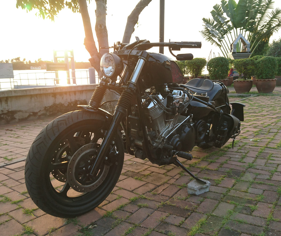

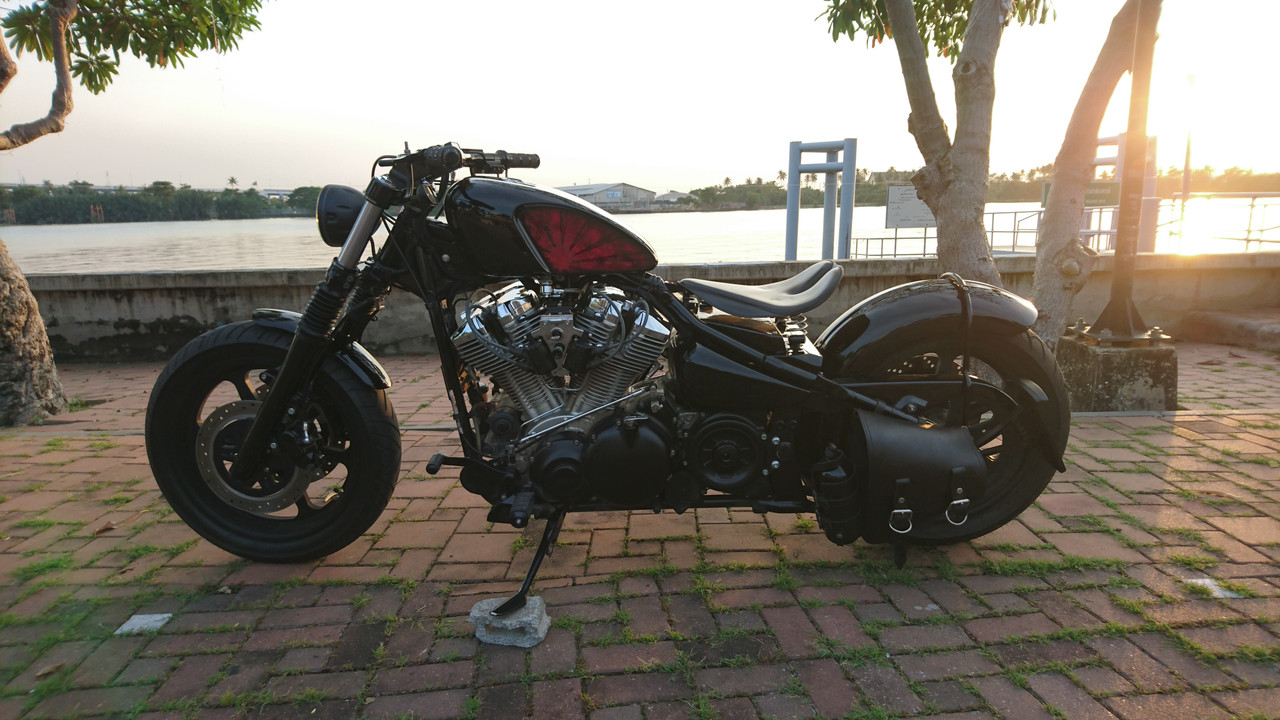

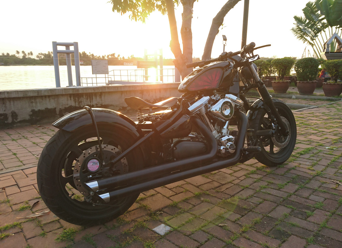

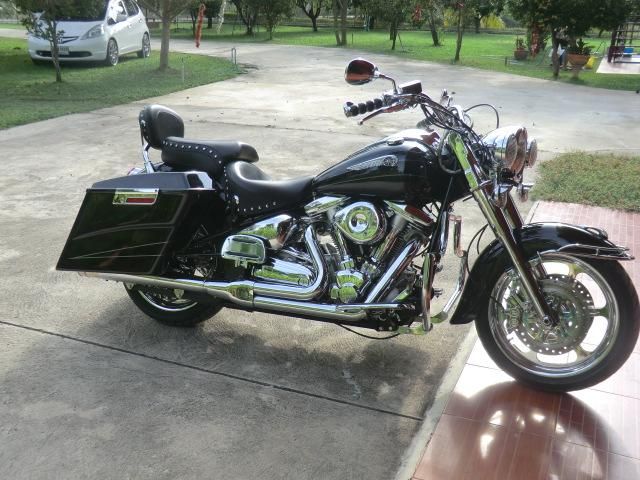

    Here are the money shots:
    These pics were taken right after the end of the build, in the meantime I've changed a few things:
    - changed the headlight, that one broke (the bracket thread was in aluminium and the mounting screw in steel, it didn't take a lot of hard riding and vibrations to strip it...). I installed a powder coated housing of the same size with a LED daymaker instead
    - Changed the teardrop air cleaner for a round one because I installed a S&S Customs oil pressure gauge and the teardrop was in the way
    - Changed the side license plate for a bigger one. The one on the pic wasn't of the legal size and I was getting too many fines from the Thai police...
    - Swapped the gel battery for a lithium Antigravity one
    That's pretty much it . I've made plenty of long rides since I've finished it, so although it doesn't look very comfortable, it is actually a pleasure to ride. I'm a big dude (6.2, 200lbs) so reaching for the drag bar is not a problem at all, and may be I have an iron butt but I can ride 300 miles per day several days in a row without discomfort. That or I just don't know what it is to ride a really comfy bike
