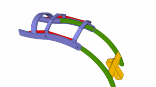

    Ironman had some plans on the old site for a hitch that integrated into the fender subframe. There are other options that have brackets outside the fender that mount to the bolt holes for the saddlebags. In my case I have RSV bags. Those have their own frame and you can replace the rear crossbar with a piece that has the receiver built into it. That's what I plan on doing.
    Ironman hitch
    Purple is subframe, red is gussets, green is arms, and yellow is crosspiece and receiver. All of this stays inside the fender and without the hitch you can't see any of it. The hitch goes up into the receiver.

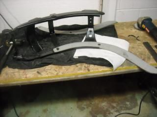

    One arm welded to the subframe.

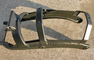

    And then Curt's gussets on a subframe for extra strength. Highly recommended.
